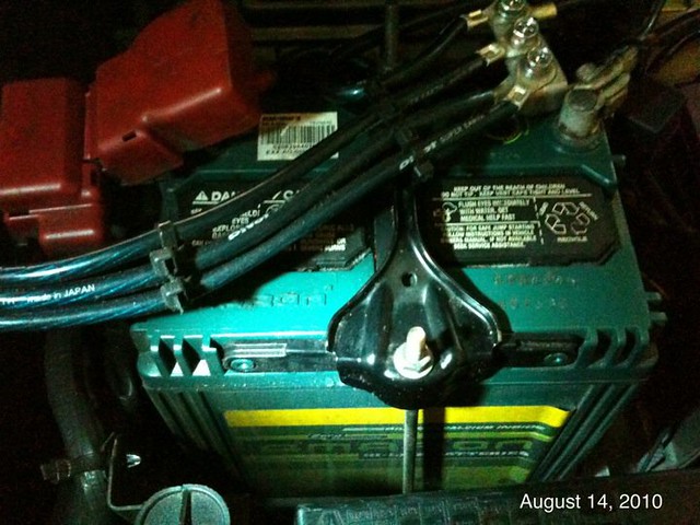

Finally my car battery walks into it's graveyard after it's served my ride for 3 yeasr and 3 months. I have been told by the foreman that the battery can last longer if I do filled battery water to it. The battery written is Zero Maintenance and I totally don't know it required battery water. LOL
The foreman shows me the condition of the dead battery and I found it is Dried and the metal part inside it is damaged.
Although my voltage stabilzer showing the dead battery is 12.7V and I check my ride's alarm system, audio, Aircon, All lights (included HID) are still function pretty well but it just couldn't start the engine. Luckily I am at home and I can jump start my ride then drive to the workshop.

Below is the picture of my dead battery which served my ride for 3 years and 3 months.
did you see the two piece of black plastic cover on top of the battery? There is the place where you can check your battery water.  :D
