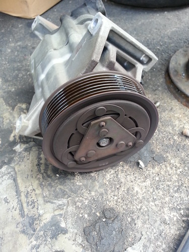

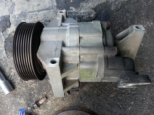

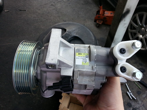

Just changed my compressor at MarkCool this morning. Total damage 560. Now aircon is back to normal and very cold  :yehyeh:
Ride is 7yrs old ++
For those interested to know how your compressor looks like, here's the pictures. It's hard to find via Google or Yahoo so I guess for the convenience to all..
