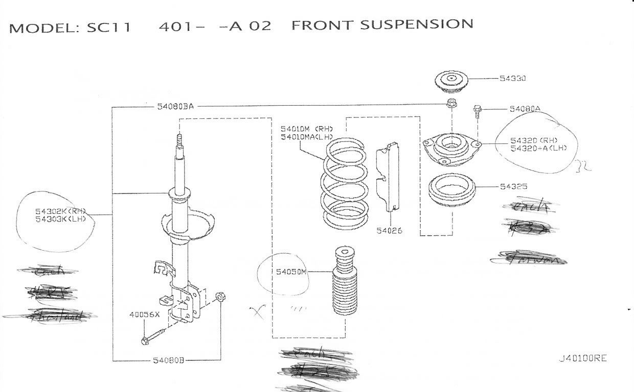

For those bros that replaced the rubber mount that solve the click tok problem... May i know which one is the rubber mount that u guys are refering to ? (refer to the attached picture) Thanks

the one that is circle up with the no.54320 on it.on the top picture :yehyeh:

I think the rubber damper or mount is 54050. And the top cap is 54320. At least these are what they look like when I got it from the stockist.  The total I paid was about $183 for a pair of rubber and top cap, since they said must change is pair..
By the way, please also confirm if your shock absorber needs changing or not.  I only got the rubber damper and top cap, but when the mechanic removed the shock absorber, he showed me its leaking. Adding on the absorber is expensive with the workshop. If I known should have gotten the absorber outside...

1. Im intending to buy KYB and the original nissan 54325, 54050 and 54320. Will it be compatible?
2. Thinking of getting KYB online from US.. anyone tried or any comments appreciated.
3. Is 54320 just a metal piece? Will it crack? From what I can observe for my ride, only 54325 and 54050 cracked.
