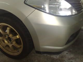

Shucks! Hit my front right bumper against a post last night:(. Bumper dented but no crack, no unusual/funny sound while driving.
Think I only need to knock back the bumper and respray.
Any kind souls with good and reasonably priced workshop to recommend? Kum siah!

Hi think your dent is too deep in, my bumper is dented in last time due to careless driving. But after that I park under the hot sun, to my surprise the dent pop out by itself.
So I only bought so touch up paint and paint back.

While I was driving an old car years ago, I was in the same situation as you. I DIY by using a hair drier to heat up the bumper to soften it, and then inserted my other hand behind the bumper from below and "pushed" it back to shape.
Not a perfect job but it was an old car anyway, so it did not bother me.

Bumper are make of fiberglass or plastic can easily push back .i managed to push out my dumper dent. why dont you try to push out the dent from behind. they should easily pop back too shape if it is not a serious knock. give a try after all no harm doing it.

Thanks all for the response. I suddenly remembered the workshop at Bukit Merah Lane where I used to send my ex Toyota Corona to many years ago. So I sent my car there at 11.00am this morning. I called the boss at 2.00pm and was told that the repair has been done. So I went down to collect. When I asked how much I had to pay him, I literally got a 'shock' when he said $30. Wa, so cheap ar! :ohmy: He told me that they had tried to polished off all the paint marks and scratches the best they could. Of course there are still many fine scratch marks left but they are not too noticeable so no need to respray. I was very satisfied with the repair and even more so with the price. $30 nia leh, where to find?! I was mentally prepared to pay $100~$200 for my silly mistake of banging into the metal pole somemore. Wa, happy like F***! :yehyeh:
