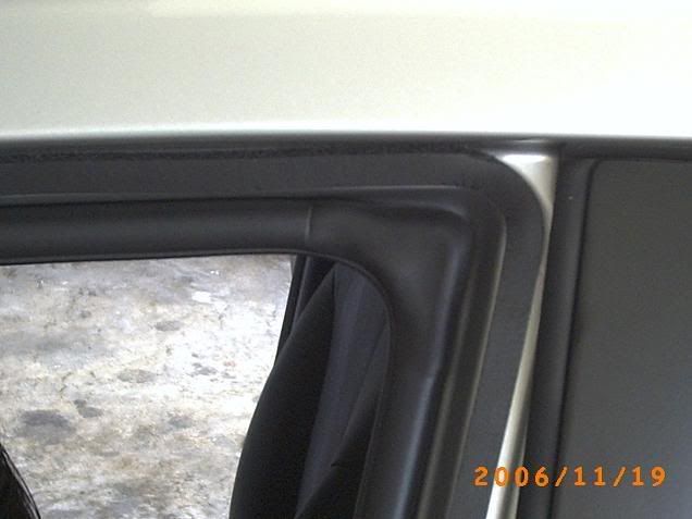

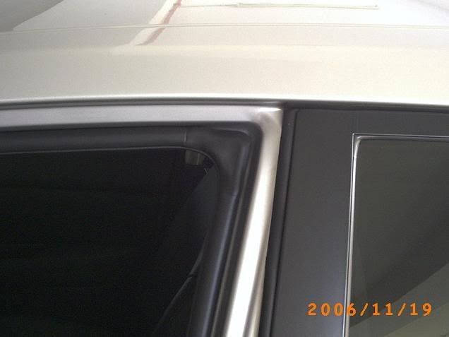

Just to share with all, I have DIYed a second door lining to help reduce the wind noise. As you all would have noticed, once our rides hit 80km/h and above, you can start to hear wind noise coming in.  :out: But with this DIYed door lining, the noise only becomes noticeable at about 100km/h and the volume of it is definitely 30-50% lower than before. :thumbsup: Best of all, this DIY lining will not cost more than $15.   :devil2: After doing the lining, I found the door harder to close because of the extra padding but its slowly getting seasoned and getting easier to close now.
here are some pics to show you what i mean.
before:
after:

Hi to all. Few months ago I did ponder the merit of this DIY idea. The insulating material can be purchased from HomeFix easily at $10/tube. There are different diameter type and length, most brown and black. So must do rough measurement of our door circumference to decide on length to get.
But in the end I rejected it because I found out that our original Latio door seals are already of double-insulation type. If you look closely there are 2 circles of the seals around each door. That is why our car has outstanding noise insulation, compare to other cars like Sunny, Lancer, etc. The more you check, the more you will appreciate our Latio quality. My opinion was that adding additional layer will not increase SP by much lah.
And adding the DIY seal will definitely make the door harder to close, which I am not sure is something I want to endure everyday. Not to pour cold water lah, just share my 2cts worth of opinion.
And while at HomeFix, maybe you want to check out a 3M product that look like a spray can costing $15 (?). You just spray its contents to the wheel arches and the foam will harden very quickly, forming a hard resin like material to supposedly increase the noise insulation property at these corners (much like that done at SP shops). My friend told me a can is good enough for more than 2 wheel archs and it feel quite heavy. But personally I feel stock is good enough but those who are interested could try out and give FR lah.

nah. no such thing as pour cold water. You're free to give your views bro. At least I know where my friend gets them.  :D  Homefix?
As for the sound insulation of our latios, I have to admit the quality is a lot better when compared to other cars in the same class but wind noise is a bother to me. Was trying to find a way to reduce the wind noise and happened to chanced upon this DIY lining at another forum. For the price and effort, I believe its a good deal especially if you drive spiritedly and always go fast on expressways.  :devil2: Hence I still stand by my pt that wind noise has been reduced 30-50% overall. Anyway, I'm going to YD today so that other bros and sis there can take a look at it and decide for themselves. Maybe can take them for testdrive also :D

My friend (driving a honda civic FD, the new one) installed a similar sound proofing strip/door lining on his car. Think if I'm not wrong its from 3M. The material is flat and quite hard. Found it quite hard to close the doors after installation. Damage = $40.
Seen corgan's door lining last evening and its quite different from what my fren had. Its round and soft, similiar to the existing door linings we have on our car. Most important of all, damage is less than half of the 3M one..... Decided to give it a try. IF its not good, can simply just throw it away without much heartache... :bleh: :bleh: :bleh:
