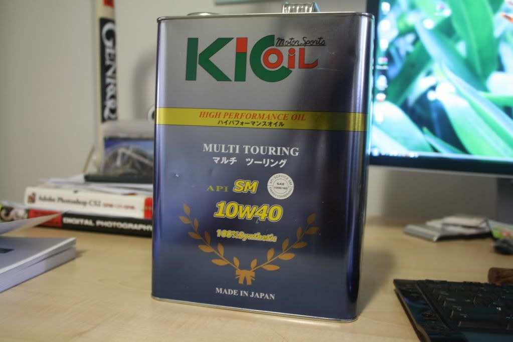

Got this oil yesterday. Gonna try it soon and give some review :)

Wow, just saw the KIC EO selling at $122, must be good stuff.
